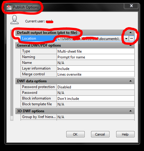

In the PUBLISH dialog box there is a button labeled "Publish Options". When one clicks on it the "Publish Options" dialog box appears and right at the top of it one sees the "Default output location (plot to file)" entry. At the very end of the line where it states the current location is a button with three dots on it (I'm assuming this is a "browse" button). Click on it then migrate to the location where you want to save your file. I hope this is what you were searching for.
