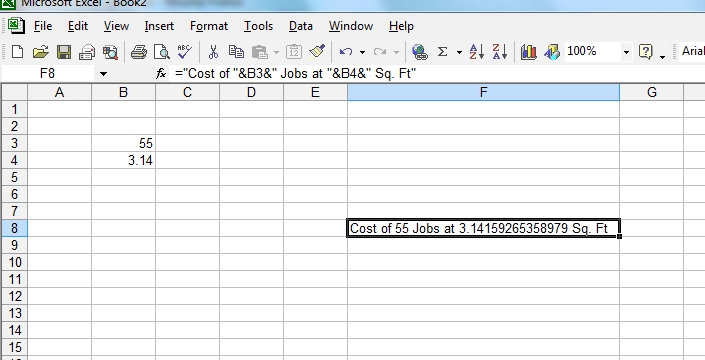

bbankston Posted December 13, 2011 Author Posted December 13, 2011 fuccaro, Awesome! It works to an extent. This works: =CONCATENATE("Cost of ",B3) This doesn't work: =CONCATENATE("Cost of ",B3 "jobs at" ,B4 "sq. ft.") Help? Quote
SLW210 Posted December 13, 2011 Posted December 13, 2011 try this =CONCATENATE("Cost of ",B3, " jobs at ", B4, " sq. ft. ",) Quote

SLW210 Posted December 13, 2011 Posted December 13, 2011 Is there something in the cells? Worked fine here. [ATTACH=CONFIG]31683[/ATTACH] Quote

bbankston Posted December 14, 2011 Author Posted December 14, 2011 Your code worked, SLW210. For some reason it didn't like where I originally put it but when I moved it - then moved it back - it worked fine. Weird. Thanks for the help! Quote
gbradley Posted December 15, 2011 Posted December 15, 2011 You can also use the Ampersand instead of Concatenate Either way, whatever value that is in your field will end up in your text, not just the truncated value. Quote
