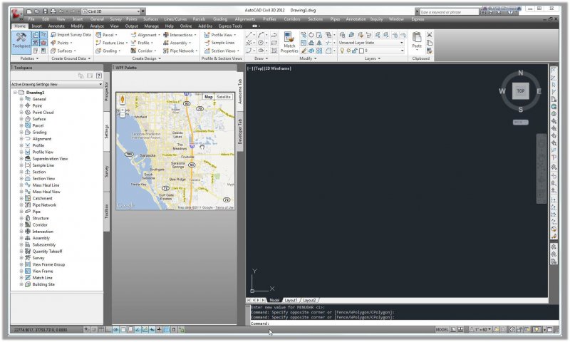

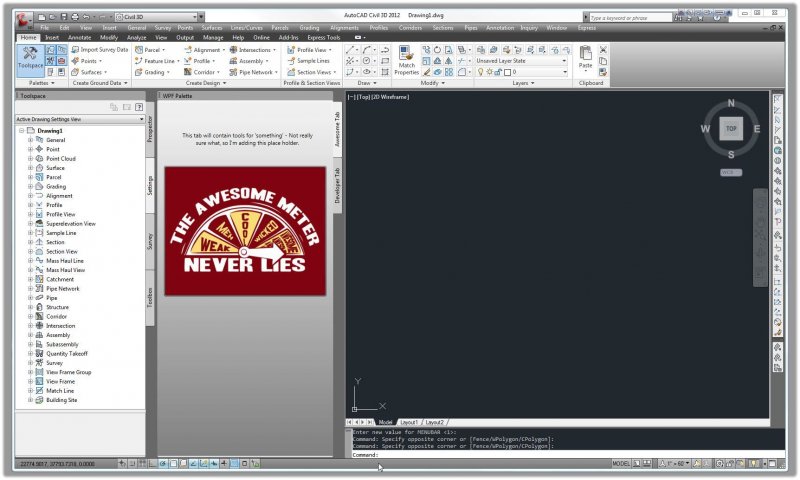

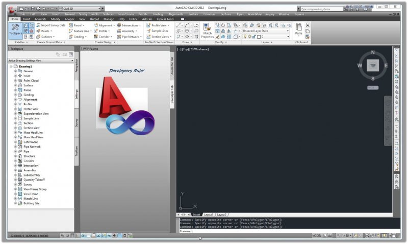

BlackBox Posted December 14, 2011 Posted December 14, 2011 (edited) Here's just a couple simple examples of what can be done (quickly) using Windows Presentation Foundation (WPF)... The first two images are of a plug-in I coded for fun from Kean's tutorial Hosting WPF content inside an AutoCAD palette. The last image is something I'm working on which incorporates the Google Maps Javascript API V3 (the free one). An implied task for what I am doing is to get the Google Maps Tool Palette, and data input from Model space to communicate (state plane coordinates translated to Lat / Lan, and back and forth), so that data input in Model space updates the Google Maps Tool Palette for reference, and such. Unfortunately though, this will not support things like street view, etc. but it is 'neat' project for me to explore, and learn from. ** Edit - The Google Maps Javascript API V3, also requires the Adobe Flex SDK. ** Note - I edited out our company logos from the WPF tool palettes shown here. They actually look a lot nicer with the logo. Edited December 14, 2011 by BlackBox Quote
resullins Posted December 14, 2011 Posted December 14, 2011 RENDER: I want that AWESOME METER!!!!!! Quote
BlackBox Posted December 14, 2011 Posted December 14, 2011 RENDER: I want that AWESOME METER!!!!!! Here you go: Quote
jmerch Posted December 14, 2011 Author Posted December 14, 2011 That is so awesome (no pun intended)...I had no idea that was a possibility in ACAD! Quote
