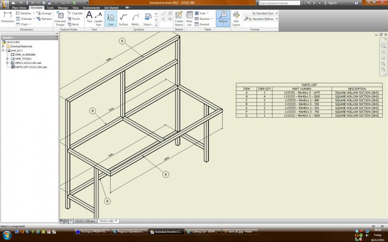

I have created a table frame using the Frame Generator in Inventor 2012.
When I insert the assembly into a drawing and add a BOM table. It is not recognising some of the sections which have been either trimmed back or mitred on the corners. It is giving me incorrect cutting lengths.
I have attached the assembly file in question.
Notice there are 2 items which are mitred at 2000mm long.
There are also 2 items that are 1920mm long.
The BOM is identifying these items as the same in the table and that it is equal to 4 items at 2000mm which is incorrect.

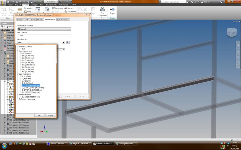

I followed your instructions to the letter, but the BOM is still only recognising 4 items instead of 2 & 2 items.
Image 2. ( i got them the wrong way around when loading them :( (bad day))
Shows the items in question. You can clearly see what is happening.
Image 1 however, shows the BOM in Document settings. I have noticed that the user parameters show
G_L(2000.00000mm) - "I'm assuming this it the initial length when creating the skeleton"
G_Offset_Start (40.000mm) - The first trim.
G_Offset_End (40.000mm) - The end trim
B_L (2000.000mm) - This surely should be the final length = to 1920mm
What an absolute pain in the backside this is.

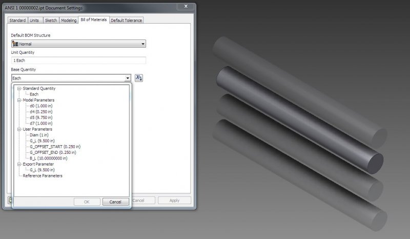

Okay, I just made a quick assembly here to look at. Made it with Frame Generator. It's just 4 1" round bars, started off with 10" lengths. Used the LENGTHEN / SHORTEN tool on the Design Tab to take 1/4" off both ends of the middle two bars.
This is the BOM tab for the second bar from the top in this picture, the one that's highlighted. B_L means (I think) BASE LENGTH. I don't know what the G in G_L stands for. My BOM shows up correctly on the .IDW file as well.
What you're seeing there is strange. I don't know why it would be showing you B_L and G_L both the same, when it shows offsets there ... Try experimenting on this with a whole new assembly, see if you can get any different results?
