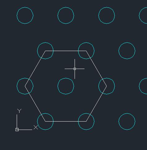

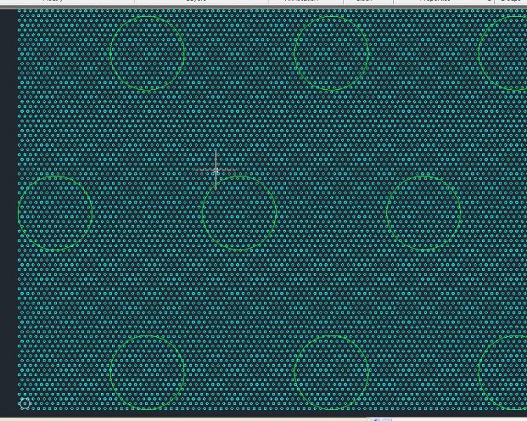

vlsf1980 Posted December 16, 2011 Posted December 16, 2011 Hi, I have a problem with my design that I can't solve. Hope someone here can help me out. I'm drawing a design that consist of 2 level of arrays. Each array is the same; circles arrange in hexagonal shape which I have no problem drawing. There is two arrays all together, with a bigger diameter circle (in green) array on top of this smaller circle array depicted in the picture below: Both arrays are in different layer. Now the problem is that I need to remove those smaller circle that are INSIDE and those that CROSSED the bigger circle parameters. I have successfully do the deleting of the smaller circles inside the larger one by using a lisp call wps.lisp but those circles that are crossed did not get deleted. Also, it only allowed me to choose 1 circle at a time, which is no use to me as I have an array of those larger circle to delete. Hope someone will know a way or recommend me a lisp that I can used for this problem. Many thanks! wps.lsp array.dwg Quote

Lee Mac Posted December 16, 2011 Posted December 16, 2011 Window over your green circles with this: (defun c:test ( / a b c e i j l n r s ) (if (setq s (ssget '((0 . "CIRCLE") (8 . "Layer1")))) (repeat (setq i (sslength s)) (setq e (entget (ssname s (setq i (1- i)))) c (cdr (assoc 10 e)) r (cdr (assoc 40 e)) l nil a (/ pi 25.) n (- a) ) (repeat 50 (setq l (cons (polar c (setq n (+ n a)) r) l)) ) (if (setq b (ssget "_CP" l '((0 . "CIRCLE") (8 . "Layer2")))) (repeat (setq j (sslength b)) (entdel (ssname b (setq j (1- j)))) ) ) ) ) (princ) ) Quote

vlsf1980 Posted December 16, 2011 Author Posted December 16, 2011 wow! thanks Lee Mac and ReMark! i almost jump out of my chair when the lisp works when i try it on my laptop (which have a old 2004 version:oops:) this forum is great! you guys save me a lot of head scratching... :D:D Quote
