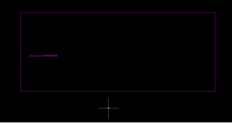

Have no idea what im doing wrong...
Trying to display a field of a linear parameter.
Keep getting the dreaded "######" as a result.
Tried regen, fieldeval to 31, some battman prompt etc etc
Please help
field.dwg
What are you getting the distance of? I got it to show some numbers after purging the file and redoing the field.
In the block editor the field will display the correct distance, but as soon as 1 close block editor and save changes, the text in displayed as "#######" in model space
well it should be 137.5mm. And when u stretch it should dynamically change after a regen. But i still cant get it to display the distance in model space. Can get it display the field distance inside the block editor, thats all.
It will kinda work if I select the line as the object, however had no luck using the linear parameter?
