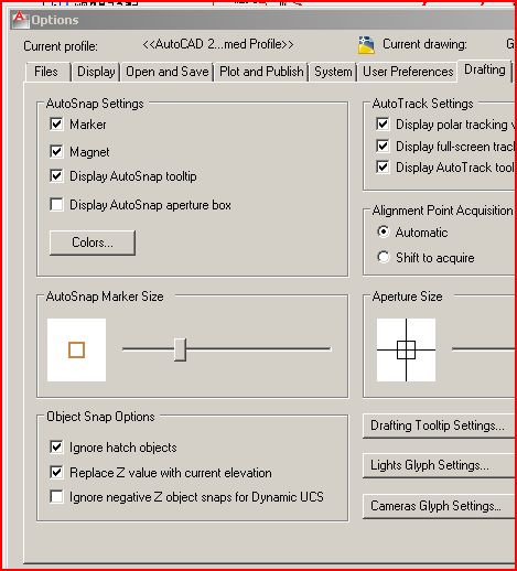

You could do that, by setting your drafting preference to disregard negative Z values while snap tracing the 3D POLYLINES.
Just adjust these drafting preferences in your OPTIONS.
