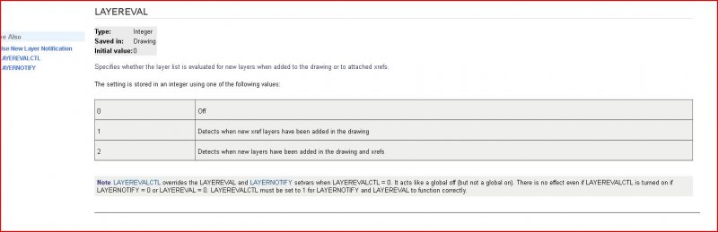

The title of this thread might be a little misleading. I am actually looking for a way to lock the ability of creating layers. I do not want all the users of the software to be able to create their own layers. I want to be the only one who can create layers and in that way I can control the standards.
Any ideas of what variable will control this function?
TIA

I don't know any way to lock the layer creation capability, but you can set your system to alert you when new layers have been added to the drawing, and you have different available options for when you wish to be notified, which you will find in the settings on the LAYER PROPERTIES MANAGER (upper right hand corner).. Not what you are hoping for, I know. If you applied a DRAWING STANDARD to your drawing it would also alert you to any offending layers.

@ ReMark. I need to update my profile, we are currently using 2010. and I am using the standards checker. I was just hoping for a way to elemenate layers everywhere as this is always the biggest violation.
@ Dadgad: Thank you, that is already a handy function, will try it out.
Dink 87522, I am not going to go into a major discussion, I guess everyone can work how they prefer. But delivering drawings to clients and then having to fix all the layers took many working hours, if I can avoid that loss, I'll be the one smiling :)
Consider using the STANDARDS command.
Otherwise, you'll have to turn to programming to accomplish what it is that you want... Or, rather, preventing users from doing what it is that you don't want them to do.
