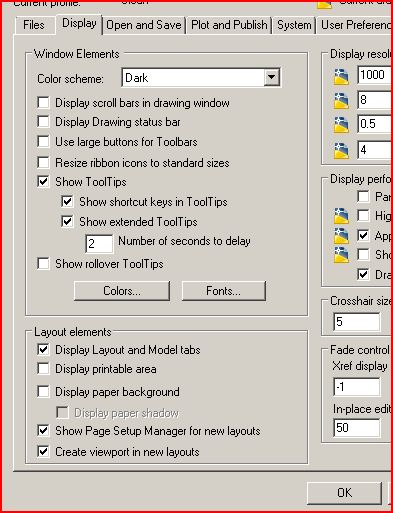

You might want to set this in your OPTIONS, so that whenever you create a new layout it will include a viewport.
