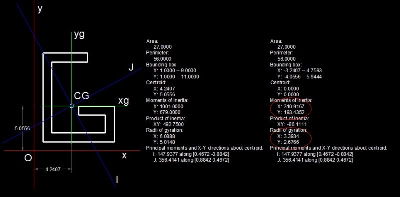

Hi Bill
About 2% differences, is the shape double symmetric? If it's not (and you can see that next to Principal Moments, if directions are different than [1.00 0.00]) then you need another method to get the correct values. I know two methods:
1) First, run _massprop and collect the centroid coordinates; then set UCS to centroid. Run _massprop once again and compare Moments Of Inertia (and not Principal moments) with AISC manual.
2) Second method required to run _massprop once and no UCS settings:
- read area A
- read centroid from _massprop - (xg, yg)
- read Moments of Inertia - (Ix, Iy)
The moments around centroid an parallel to x and y axis:
Ixg = Ix - A*yg^2
Iyg = Iy - A*xg^2
Radii of gyration:
rxg = sqrt (Ixg / A)
ryg = sqrt (Iyg / A)
See the picture. First results are around WCS axis and second around Center of gravity.massprop.jpg
