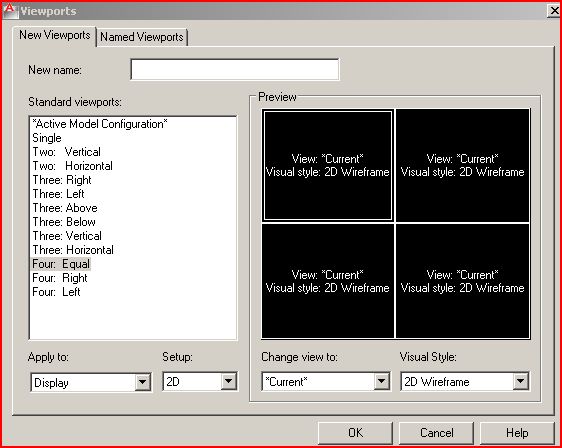

Dadgad Posted December 24, 2011 Posted December 24, 2011 This is the viewport display dialog box. If you have your VIEWSPACE toolbar open, you will find the button for this. Quote

The Mad Cadder Posted December 24, 2011 Author Posted December 24, 2011 This is the viewport display dialog box. If you have your VIEWSPACE toolbar open, you will find the button for this. If I use this function of ACAD, can I re-size the size of the viewports to suit the needs of the object I'm creating? Thanks. TMC Quote
