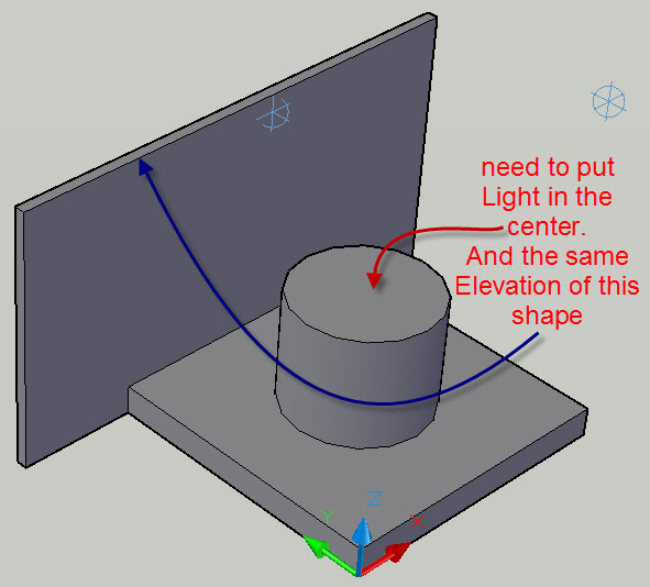

How can I put a light or a point on the center of a rectangle or a circle,and take the elevation from another shape as shown on this picture.
I have tried with Point Filters but the point isn't on the middle and the elevation that I want :(
This is how I did it:
http://s18.postimage.org/8gdjs1ghz/Untitled2.gif
Thank you .

I am not able to view how you did it, but here is how I would use the Point Filters.
Firstly, I would take a .XY filter to get the plan position, then using the .Z filter to get the elevation (using Osnaps as necessary to get the exact values) :D

Eldon is correct, the .XY is better to use if you know the exact point in the Plan View. But I think the reason why you had an error is in your method of choosing the X and the Y. You were backwards. Going by the image you uploaded, for each of the X and the Y point filter, swap the order in which you were choosing.
Think about it. When you chose the X filter, you picked parallel to the X axis, not perpendicular to it. You want to pick positive or negative along the X axis, not right on the axis itself. Try that and see if it works too, just to resolve the issue you had.
