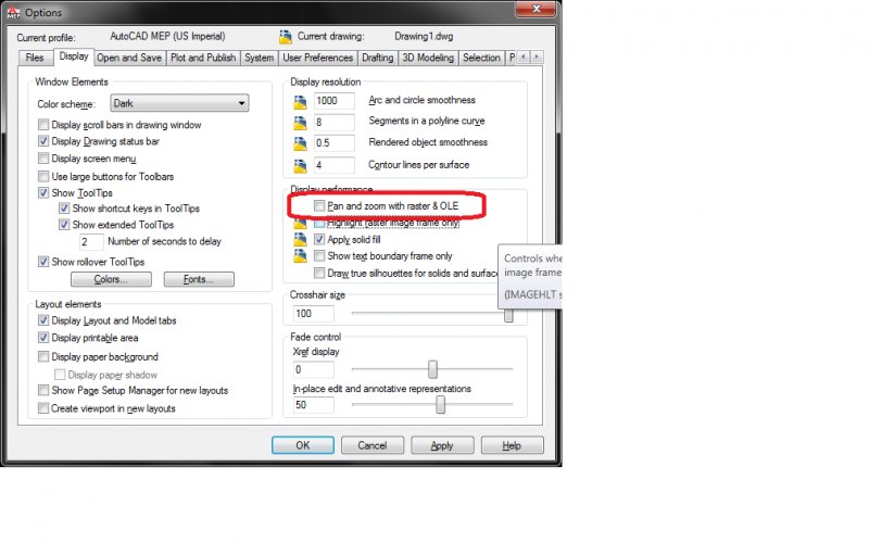

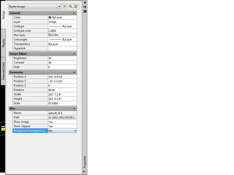

RobDraw Posted December 27, 2011 Posted December 27, 2011 I do this on a regular basis. I have not had the luxory of being able to insert PDFs, yet. I always use tif files. I can't rember why, just that I've been doing that way for years. In the properties box there is an option for "Transparency". It's a toggle, on and off. It makes it so that Autocad objects can be seen through the image. There is an AutoCAD option that might be of help with the performance issues when panning and zooming with PDFs. See attached image (lol). Your dialog box may look different. Quote
RMerrell Posted December 27, 2011 Author Posted December 27, 2011 The Mac OS comes with preview which is similar to Adobe Viewer only more powerful. It allows me to change the file type from PDF to Tiff, JPG, PNG... I can take a PDF and save as a black and white PDF then do another save as any of the images files. However, none of these will be transparent when I switched the properties button you mentioned. That's why I'm looking for a 3rd party software that y'all know will work. I'll try that display setting. I don't recall seeing that button before. Quote
RobDraw Posted December 27, 2011 Posted December 27, 2011 I'm sorry. The box in the options is called "Background Transparency". Select "Yes" not "No" as shown in the image. Quote
RMerrell Posted December 27, 2011 Author Posted December 27, 2011 I don't have the option you've circled under my display tab. Several others are missing as well. Are you running the full version of Acad. I'm got Lt so it may be an Lt thing. Quote
RMerrell Posted December 27, 2011 Author Posted December 27, 2011 Yes, I've tried clicking that button with all of the different image file types available to me through preview and then regening to make sure. None of them worked. I'm hoping for a 3rd party software recommendation to fix that. I have some PDFs that attach with the transparent background that I have converted to all the different image file types and inserted and clicked that button and it just won't work for me. Quote
RobDraw Posted December 27, 2011 Posted December 27, 2011 Sorry about that. If the option is there, it should work. I use it quite frequently. I don't know what else to say. Quote
