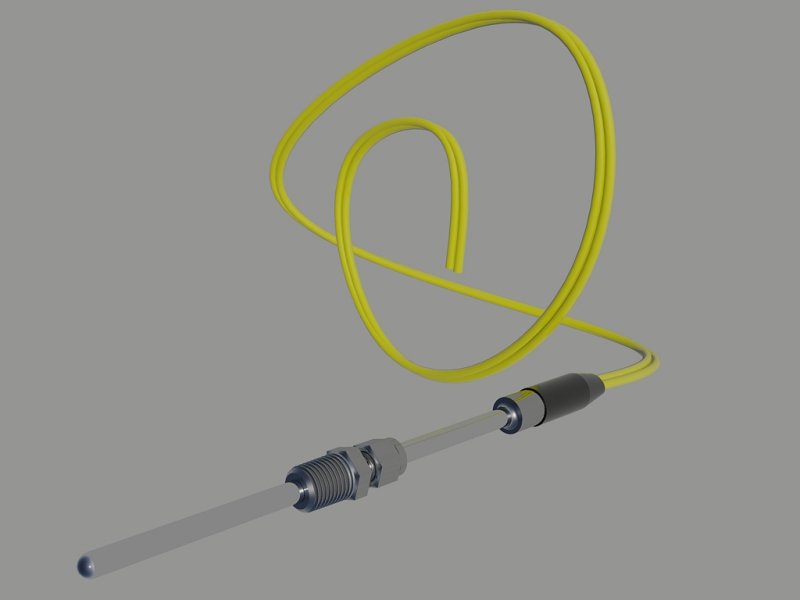

Nick@TE-Direct Posted December 27, 2011 Posted December 27, 2011 Hey guys- I am having trouble making a white backgound while being in Sun & Sky mode. I tried placing a large object behind my current object and placing a white material on that but it comes out grey. Any tips? Thank You in advance! Quote

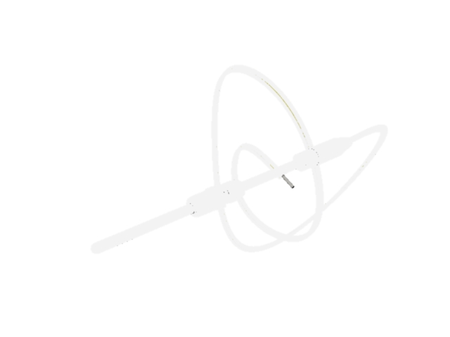

Nick@TE-Direct Posted December 27, 2011 Author Posted December 27, 2011 Okay, now i did what you mentioned in your post but that is just the same as typing 'BACKGROUND' and changing the background to white. It now washes out the whole rendering and does not hold the sun & sky quality of the rendering. I basically what to have my sun & sky render but with a white background instead of the defaulted grey. Quote
Nick@TE-Direct Posted December 27, 2011 Author Posted December 27, 2011 Here are the examples, first with sun & sky, second with white background Quote

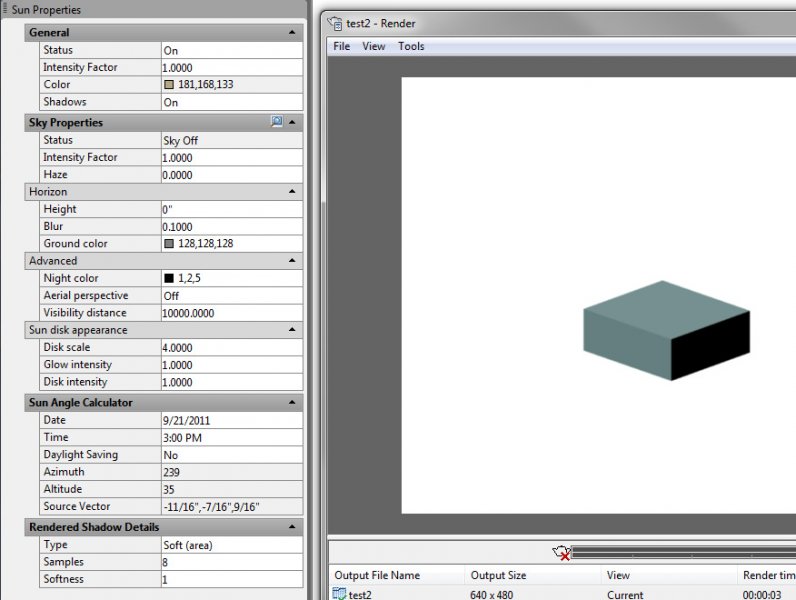

Cad64 Posted December 28, 2011 Posted December 28, 2011 It works for me. Here's a screenshot of my sun properties along with a quick render of a box on a white background. Quote
ReMark Posted December 28, 2011 Posted December 28, 2011 Nick: Did you notice the screenshot above? The status of sky properties is set to OFF. Quote
