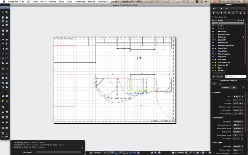

The viewport-thing seems to be quite interesting. Unfortunatly it seems not to be the answer to my question. I put in some shots this time to be clearer...
And let me add my aim: plotting.

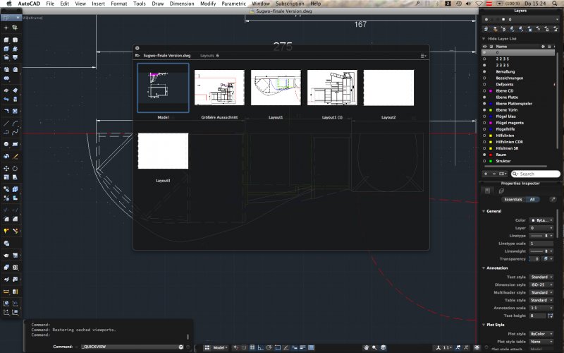

For preparing a plot from the modelspace I move here:

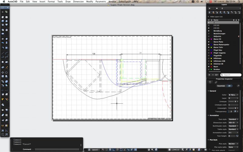

Now I am in "Layout 1".When zooming in this specific layout the drawing is zoomed:
Now when I click on the icon on the bottom saying "Lock/unlock viewports" and then zoom I zoom the whole paperspace:
