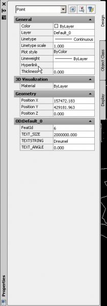

I've a few points with some attributes (select point,properties and you see the different attributes of this point), one of those attributes is a textstring.
It has a value (Dreumel). This textstring (value) is what i want to see and put in to the drawing. I want to display this value
See the attachment please.
And how to this with many more points?
That property is an AutoCAD MAP3D object (object data table vaule). You can use the map3d anno blocks to label those points, or do a alter-property query and add text, or convert the points to SDF and data connect then label or.......... See there's a number of ways of doing it. The quickest for me would be the annon blocks.
