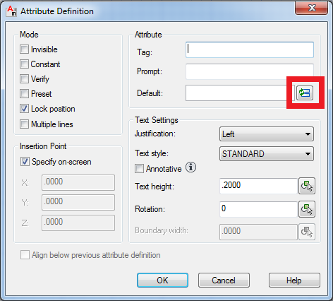

You can do this, by setting the default attribute text as an field, according to the picture below.
As fieldname, select Filename.
