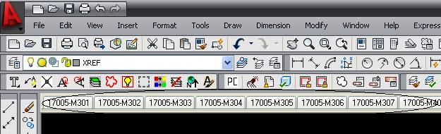

since im getting some help on Lisping etc i thought id share a great little feature we have here.
Basically it puts all your opened drawings as a folder either above or below the working area of AutoCAD (we have it on 2004 to 2009 and it works with all)

Little folders are shown either above or below the drawing with all opened drawings names.
You can right click on the folders to set a preference of having it either above or below working area of drawings (i prefer above). like the .JPG ive attached.

Does anyone else get the 'flickering' when switching between drawings using this tool? Is there any way to stop it?

found this note on their website:
Please note, we are having problems working with Microsoft Vista and XP 64 and do not support these versions at this time. Drawing Tabs will install within the Vista operating system, but has video problems and causes the screen to flicker.
I guess I need to keep an eye out there for a fix....

Command: APPLOAD
cl-DwgMan_07-08.arx is incompatible with this version of AutoCAD.
AcRxDynamicLinker failed to load 'C:\Program Files\caelink\cl-DwgMan_07-08.arx'
C:\Program Files\AutoCAD 2004\acad.exeUnable to load cl-DwgMan_07-08.arx file.
