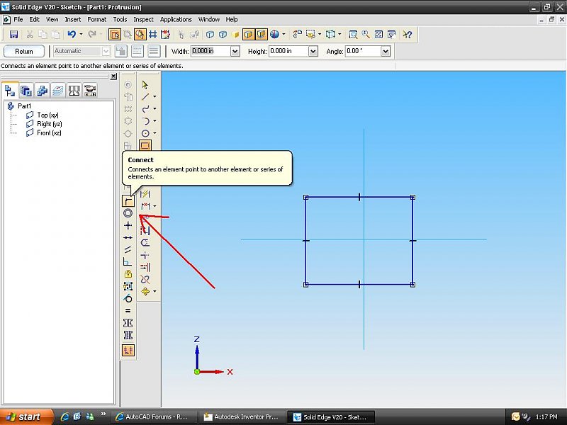

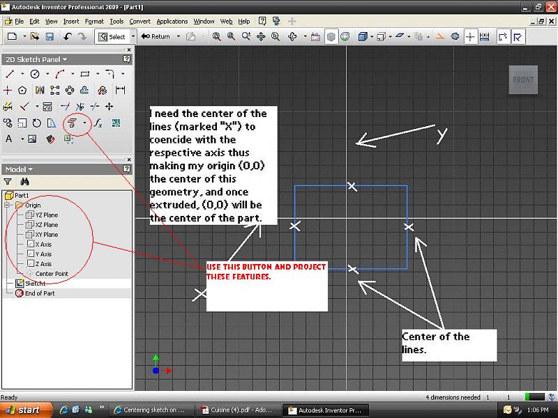

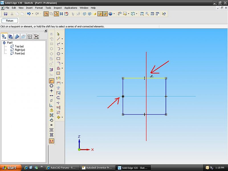

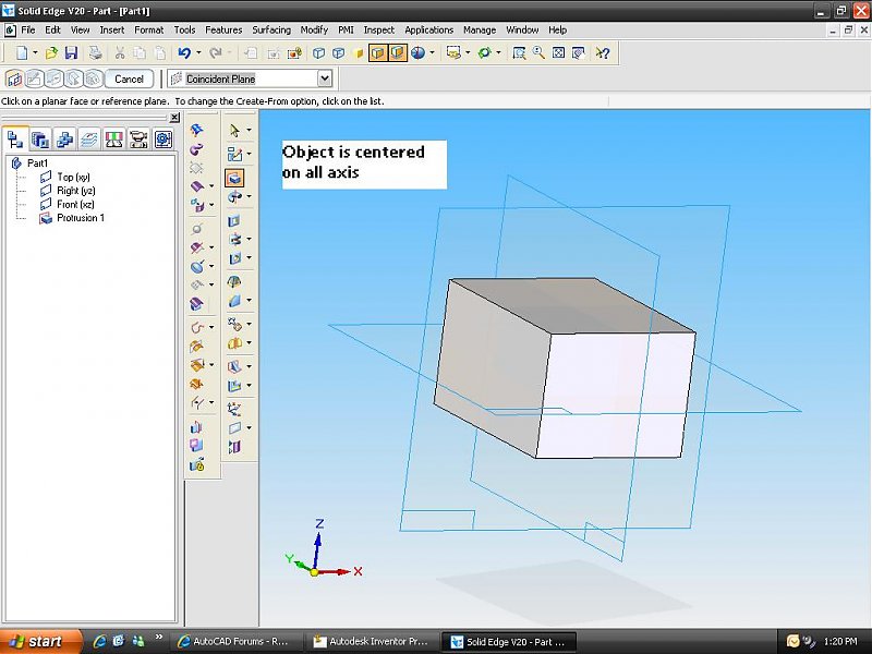

RainMan52 Posted October 21, 2008 Author Posted October 21, 2008 ok..here's my problem youll find the info on the screenshots. in solid edge (image name: SolidE1 up to SolidE3) there is an option for this called "connect" where you can connect the center of a line to any other element in the drawing space even the axis. that way, you can center and constrain your geometry to the center of the axis in question. My teacher just tought us this modeling procedure where when your geometry and part is centerd to all axis it's easier to Edit instead of creating a new plane each time you want to mirror something or edit something else that needs a referance. I can't seem to find a similar option on Inventor and I've been using it for about 6 moths now. (imge name: My screen) Look at the images and tell me what you think...hope it's less confusing now. Quote
RainMan52 Posted October 21, 2008 Author Posted October 21, 2008 This is what I'm trying to achieve. and please don't even ask me how I did it...it's so obvious and a bad way to work, that i don,t even want to discribe it....it would bring disonor to this board... Quote
Aardvark Posted October 21, 2008 Posted October 21, 2008 Did you read my first post? There is a check box in tools/options ( I cannot remember which tab but probably sketch) that will automatically project the origin point into new sketches. You can then constrain your sketch to the origin point. Or you can do this manually by selecting the "project geometry" tool and selecting the origin points,axis, or planes from your model tree. Quote

Aardvark Posted October 21, 2008 Posted October 21, 2008 I would draw a construction line between the corners and constrain the origin to the midpoint of my construction line (Tip #21 on page 8 of this document; http://home.pct.edu/~jmather/AU2007/MA105-1L%20Mather.pdf have you read this yet? If not I would highly recommend it.). Quote

RainMan52 Posted October 21, 2008 Author Posted October 21, 2008 I would draw a construction line between the corners and constrain the origin to the midpoint of my construction line (Tip #21 on page 8 of this document; have you read this yet? If not I would highly recommend it.). that,s exacly what I did in the inventor screenrint.. But I'm an architectual carpenter so i rarely have a rectangle on my screen and it losses all constraints to the center point once you start editing it... Quote
RainMan52 Posted October 21, 2008 Author Posted October 21, 2008 Did you read my first post? There is a check box in tools/options ( I cannot remember which tab but probably sketch) that will automatically project the origin point into new sketches. You can then constrain your sketch to the origin point. Or you can do this manually by selecting the "project geometry" tool and selecting the origin points,axis, or planes from your model tree. you simply see the center point and can connect to it but you don,t have any constraint to it, unless you do some geometric acrobatics with your sketch... it it's not really realistic in a production environement. especially when you have to manually "write" G code fro a CNC (yeah i know there are softwares out there) ...but try telling that to my boss after he has spend quite a lil forturne for Inventor and the upgrades...) Quote
Aardvark Posted October 22, 2008 Posted October 22, 2008 Projecting the geometry creates actual geometry that you can constrain to. Yes, it should auto-constrain if you have the geometry projected. In your screenshot I only see the grid lines (which are not geometry and cannot be constrained to. They will produce "soft" constraints which means that it will snap to the point but not attach with a constraint.). Furthermore, I don't see any construction lines in your screenshot. For examples of this and how it will react to different changes of the sketch see JD's document that I have posted several links to. (JD if only you and I got royalties every time I mentioned that document....) Quote
