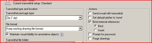

Go into the TRANSMITTAL SETUPS dialog, or choose whatever transmittal setup you are using, and select MODIFY. A number of options there you might want to consider.
Done that there is no option called insert
Ah, sorry, I see that you are on 2009, in 2012 there is.
