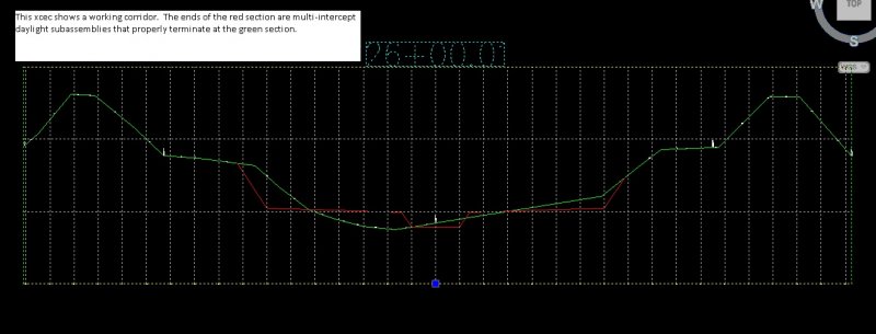

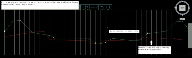

BenE Posted January 6, 2012 Posted January 6, 2012 Hi guys, I haven't experienced this problem before. I have four corridors in the drawing. Three of them work perfectly. One of them won't hit the target - it just passes straight on through. The daylight featureline is discontinuous (it shouldn't be), so I can't create a boundary from it. I'm attaching snapshots of a working and wacky cross sections. -Ben Quote
ScribbleJ Posted January 6, 2012 Posted January 6, 2012 The one thing that comes to mind to me would be your assembly/template. Does it take into account for the conditions at that station? It doesn't seem to be any difference between the two as far as conditions go but I have had issues with assemblies being the problem with consideration to the parameters setup for each possible condition. Quote
BenE Posted January 6, 2012 Author Posted January 6, 2012 (edited) Well, all of the assemblies in the drawing (there are five) are made one of two ways. Three subassemblies are created from polylines, with exception to the daylighting subassemblies on the left and right ends. The entire affected corridor is built this way and is out of wack. Every section shows the daylighting missing the assigned target surface. The remaining two corridors include transition lanes that targed to offset alignments for widening of the corridor. These appear to work fine. Edited January 6, 2012 by BenE corrected number of corridors, clarifying a poorly written response and then clarifying the clarification! Quote
ScribbleJ Posted January 6, 2012 Posted January 6, 2012 I hate to even suggest this but try and delete the corridor and re-run it. Try it in a copy of the file and see what the results are. Also purge and audit the file as many times as it takes to remove any errors. I make it a habit to purge and audit quite often. Quote
BenE Posted January 6, 2012 Author Posted January 6, 2012 It looks like you and I are on the same page. I just finished deleting all corridors, creating a single corridor composed of each assembly and alignment, purging, auditing, saving, creating new sections and surface. I get the same problem in the region of the old problem. Quote
BenE Posted January 6, 2012 Author Posted January 6, 2012 The target surface is a shortcut that has been promoted in the current drawing. Perhaps I need to start looking there.... Quote
BenE Posted January 6, 2012 Author Posted January 6, 2012 (edited) I'm including another picture that may help - Edited January 6, 2012 by BenE cropped picture Quote
ScribbleJ Posted January 6, 2012 Posted January 6, 2012 The target surface is a shortcut that has been promoted in the current drawing. Perhaps I need to start looking there.... I don't put anything past AutoCad/Civil 3D considering how quirky it can be but I would think that the surface being in the same drawing wouldn't cause the problem. Try creating the surface in a new drawing file and use a data shortcut to it. The amount of data in one file can be problematic with Civil 3D. I had one project where the design surface was broken down into about 6 different drawings with a data shortcuts for all the others that were adjacent. At this point I'm just tossing out ideas here to assist your thought process. Quote
BenE Posted January 6, 2012 Author Posted January 6, 2012 I'm right there with you. Just tried breaking the original surface in two... Thanks for your committment to the thread! Quote
BenE Posted January 6, 2012 Author Posted January 6, 2012 Well, I am about ready to cry uncle and start from scratch. Any last ideas? Quote
ScribbleJ Posted January 6, 2012 Posted January 6, 2012 Uuugh! Not Uncle already! Review your assembly very carefully; (the daylight part of it). Or even create a new one from scratch and using it. I would bet (if I were a betting man) the assembly is the problem not the surface or corridors. Maybe even try doing something different for that condition (even if it doesn't meet your criteria) just to see if you get the results you expect. Quote
BenE Posted January 6, 2012 Author Posted January 6, 2012 Well I waited a day and a half before I posted on here. I'm losing too much time. I did rebuild the problematic assembly, checked it's parameters, created a new corridor, checked the targets, imported a different target surface. I am beginning to suspect that something in the drawing is corrupt. Thanks again for your help ScribbbleJ. Hope you get to enjoy this nice weather this weekend! -Ben Quote
