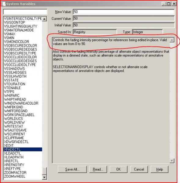

I use refedit quite a bit and I think there is a setting that allows you to only SHADE the objects not being edited. Maybe this setting is set to black (since you have a black background)? If I can find/remember the command, I'll update you.
I'm guessing you might be talking about this one?
But I don't believe this will do what zandala (welcome to the forum, by the way :) ) is looking for.
Why should similar blocks be hidden when you do a refedit unless you specifically wanted them to be hidden??
Maybe this will help. When you enter refedit, it's like checking out the block definition. It is not a live edit of the block. The drawing is waiting for the new definition so it can be applied to the block. A lot of things in AutoCAD, like the layer manager and MText, used to be like this. You could make a ton of changes but they wouldn't be shown in the drawing until you exited to dialog box. Maybe refedit will catch up with a future release but for now, I think you will just have to deal with it.
