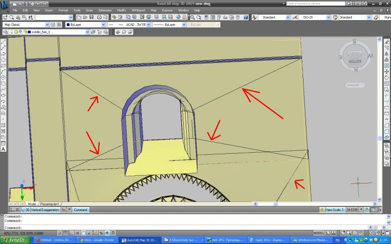

Hello everyone! I would like to know if there is a possible way that the borders that the 3dface command creats will not be visible. I am attaching a foto in order to explain it better. the red arrows at the foto show the borders that i don t want to be seen at the final product.
In order to make it more clear, i have to say that these borders are not lines that i have drawed. these are lines that are created by choosing the 4 points that the 3dface command needs.

When you first constructed your 3DFace you had an option to make it invisible.
From your AutoCAD HELP file re: the 3DFACE command option....
INVISIBLE
Controls which edges of a 3D face are visible, allowing for accurate modeling of objects with holes. Entering i or invisible before the first point of an edge makes the edge invisible.
The invisible specification must precede any object snap modes, XYZ filters, or coordinate input for that edge. You can create a 3D face in which all edges are invisible. Such a face is a phantom; it does not appear in wireframe presentations but can hide material in line drawings. 3D faces do appear in shaded renderings.
thanks a lot!!!! it worked..
