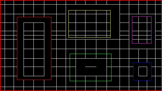

I just want to trim the poly lines within the boundary selected by user.Lines to be trimmed exactly at the intersection of line and the rectangle....

Use the TRIM command, as follows.
TRIM > ENTER > ENTER > make your selection with a crossing box (starting from right and moving to the left).
I am not sure if you are wondering how to do this, or are looking for coding help.
I need to do this through VBA coding.all the lines outside of the selected boundary should be deleted.
