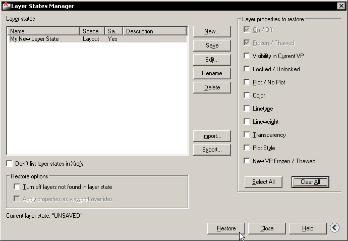

I run into this quite frequently and I don't think there is a way to do exactly what you desire. What I do is change the name of the layer in the XREF slightly. If it's named A-ANNO, I'll change it to A_ANNO.
Thank you for the response Rob. Glad to hear that I am not the only one who has faced this challenge. I did figure out a work around that works well enough for me. I keep the base drawing open, open the xref make the change and save it, go back into the open base map and change visretain to 0 and click on the pop up (not sure if this is available on previous versions) to reload the xref, then change visretain=1. I then freeze the layer I didn't want in all view ports. I think if I had to have certain layers frozen in some view ports and not in others this might not work so well, but since it is primarily a few layers frozen in all view ports, it seems to work. The key for me was not to close the base and reopen it with visretain=0, as it would reset everything.
Have you tried using Layer States? You can save the layer state prior to editing the xref, then set VisRetain=0, reload it, set VisRetain=1, then open the Layer States manager, selec the state you saved, click the "Clear All" button in the "Layer properties to restore" group on the right, then click the "Restore" button at the bottom.
Note that the On/Off and Frozen/Thawed properties is always restored - you can only omit other properties like Colour, Linetype, etc. If you can't see the properties, click the round "Expand" button at the bottom right (it should have a image like a Greater-Than sign).
I have been playing around with the layer states and they do work well, just as you described. They work well when the xref is changed while the base map is open so that visretain can be changed from 1 to 0, update the drawing, change visretain back to 1 and restore the layer state, but I cannot get them to work when I set visretain to 0 and close and reopen the drawing. I figured that if I had to change a bunch of drawings I could just make visretain=0, save the drawing, close it, reopen the drawing and restore all my settings with the layer state, but this doesn't work. I am not very familiar with layer states and was wondering if I was missing something or maybe they don't work in that way.
Thanks for the help.
Josh
Well, the problem I have with LS is that it's all layers or none. You can't pick which layers to adjust. And also you need to perform a LS restore inside each VP is you've got VPFreeze and / or VP Overrides ... which could be a schlep. Luckily there is a method of automating these through lisp, but it's a bit "advanced".
The biggest issue with LS is that it tends to break, or at least perform strangely when you start adding / removing / renaming layers.

I have this problem all the time - last week I tried something out of the blue though. After I changed VISRETAIN to 0 and reloaded the xref, I did an UNDO - and the layers went back to where they were. I would love to know if this works for everyone or if its just my particular combination of files that lets it work.

OK, I've made a Lisp for reloading selected layer's selected properties from the xref:

Save this into a LSP file and have it loaded through one of these methods: http://lee-mac.com/autoloading.html
Then you should have a new command: XLayerReload. This opens a dialog with all the xrefs in a drop-down at the top-left. When you change the current XRef - all its layers are displayed in the list box below. Select all the layers you want to reload (use Shift or Ctrl click to select more than one). On the right check which properties need to be reloaded. Then click the Apply button, you can apply more than once.
Note this command disregards VisRetain (as it should) and any such changes are permanent ... may need to wrap it into an undo group in the future so changes can be undone in one go instead of several.
Also the VPFreeze / VP Override hasn't been implemented yet, so currently they do nothing. In the future this would probably apply such reloads to all viewports in the current DWG as well (not just the model space).

Thank you for the Lisp; I'll have to spend some time with this.
How long did it take you to write something like this?
Oh, about 4 hours ... lots of copy n paste from other code of mine. Most of the time was taken up with debugging.

this is just what I was looking for - thanks irneb
only trouble is, I can't make it work!
dialog box opens, I untick everything except 'color', select my xref and layer, hit 'apply' and..... nothing.
box stays open, nothing happens. as if 'apply' button is disconnected!
after more tries, I've notice that no layers show up if you have the xref open. but still, I have no joy. seems like its dead. is it a version thing?
would appreciate knowing if anyone else can make it work. Thanks all.
okay got it. need to reload the xrefs manually after using.
excellent code, thanks!
