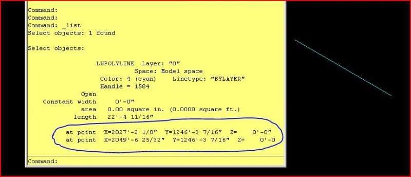

I need to know how to get the start and end points of a polyline. I'm a rookie at this and just learned how to pull out the start and endpoints of a line and when I went to do it to a polyline I was completely lost.

I doubt this was how you did it way back on Autocad 2000, but on 2012 at the commandline type LIST> ENTER then select your polyline or line, or whatever else, then look down at the bottom of the list for the coordinates, as shown on the attachment.
Whoops, I have inadvertently strayed into the deep end of the pool, just noticed that you are looking for coding help. Never mind.
