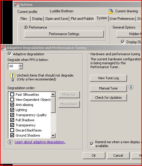

Dadgad Posted January 13, 2012 Posted January 13, 2012 I notice that if I have several drawings open my AutoCAD slows down quite abit. This also happens if I have AutoCAD open and I open several drawings one at a time. I looked for the paging file but I cannot find it to adjust the max size. Is this where I should be looking and if so how do I get there? If I shut down AutoCAD and restart it the program works faster for the first few drawings. My machine has been upgraded to 6 gig of ram and the OS is Windows 7 pro. Do you use adaptive degradation? Probably not going to make a huge difference, but it might help keep your speed more consistent. And what is your incremental save percentage set to? Quote
