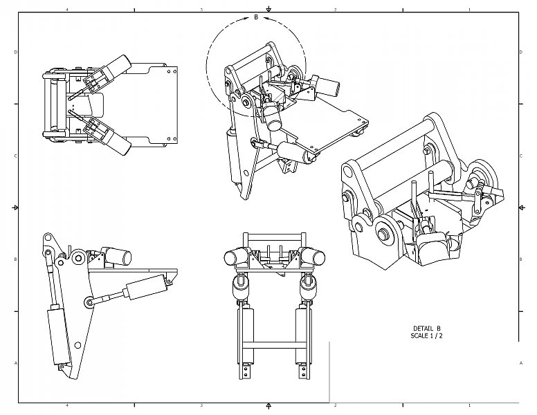

also along the same subject but slightly different, when you mirror something, then say you go to make a presentation file of the assembly or disassembly of the file, moving one of the mirrored components moves the other. Is there a way to disassociate them? It's only happened to me once and it was an instance where i copied sub assemblies in a larger assembly.

david, this is the design i specifically had mirrored components in because everything symetrical. In this instance there was no mirroring in a sketch plane but rather mirroring of components. This worked for the animation as well(except the cylinders that are at an angle to the body). These had to be copies with their own constraints since they were not perpendicular to eachother. I had to revise this file several times to change the base plate width for different width rollers, bearings etc and what i had to do was change the offset of my mirror plane(which was high up in my hiearchy) and all the mirrored components shifted. Im sure this wasnt the best way to do this but it was how i found to work. I have no training on inventor and ive just fumbled through to aclimate myself so I will definately go and read that document you linked me to. THANKS!

Look into "flexible" assemblies. Leave the throw length in the cylinder assemblies unconstrained, then in the upper level assembly, RMB the cylinders and make them "flexible" (not Adaptive). You can then constrain the ends of the cylinders independently and they will adjust in length but it will not effect the original definition.
how would you constrain the cylinder body/piston? I used a pin constraint and when i annimate i change the offset number as my stroke. If i dont constrain this? how will i get the cylinder body/piston together?
Just use a centerline mate. Don't worry that the piston can exit the cylinder body this will be controlled in the top level assembly.
