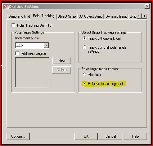

The program default for this behaviour is Relative, it used to be Absolute. Relative is in my opinion preferable, and a great time saver compared to Absolute. This setting can be found, for those who prefer changing it in the Polar Tracking tab of the drafting setting dialog box, as shown in the attachment.
