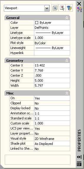

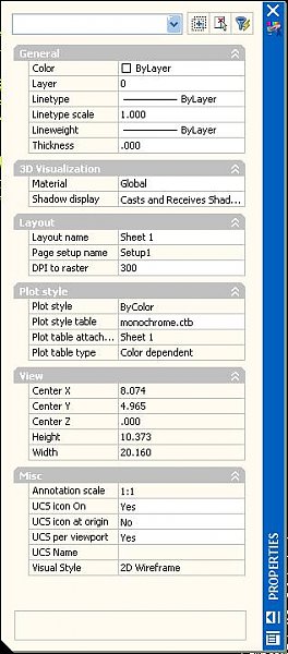

Jordan87 Posted October 16, 2008 Posted October 16, 2008 I am having the same problem, except the properties palette will not even work for viewports. Usually when I select a viewport, the word "Viewport" appears in the selection drop-down box at the top of the properties palette. Now when I select any viewport, the drop-down is blank. It doesn't even have a "No selection" dialog in the box. Along with that, it is also missing most of the misc tools. I have attached two pictures showing what I have just explained. I can answer any additional detail questions, so please help. Note: both screenshots were taken while the palette had a viewport selected. Quote
JuanAlvarez Posted October 11, 2016 Posted October 11, 2016 I guess that by this time you have already solved your problem but If any other may have the same problem I found on the autodesk official forum this: https://knowledge.autodesk.com/support/autocad/troubleshooting/caas/sfdcarticles/sfdcarticles/Properties-palette-is-blank-and-does-not-work-in-AutoCAD.html It seems to be related to Autodesk 360 not properly installed/unistalled. Quote
RobDraw Posted October 12, 2016 Posted October 12, 2016 Not in 2006. A360 wasn't even a thing back then. Quote
