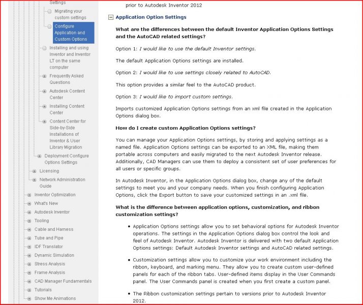

In your OPTIONS, on the FILE tab you can set your template preferences by clicking on template settings and designating amongst other things, your default template file name for QNEW.
At least that is what you would do in any other Autocad product with which I am familiar. Having just looked on INVENTOR FUSION I am mystified by my inability to locate the OPTIONS.
Searching on the WIKI help for INVENTOR I see this, but am time constrained, racing out the door. It is different on Inventor, but it you want to set more familiar AUTOCD style options you can by importing an .xml file. Surely somebody conversant in INVENTOR will help you sort it out, if you are unable to.
