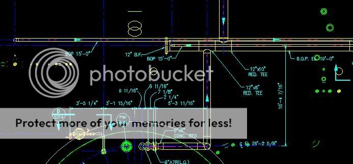

Ive been having problems when cutting section views and elevations using the 3dclipping command. in the viewports im seeing ghost objects and lines that do not show up in the plots, but when im viewing it in paperspace, the drawing is filled with the invinsible "Ghost" objects and lines that are in clearly not within the clipping "slice". is this just a problem i am going to have to live with, or is there a variable/command that i can implement to get rid of the nuisances? i can get a screen shot if need be.
may i ask if your viewport is in 2wireframe or 3d wireframe/realistic?
i will get a screenshot.
it is 2d wireframe
this is what im getting in the viewports. the "ghost" lines and circles do not plot, but im sure you can imagine they are quite a nuisance when trying to annotate these plan drawings
are they located on different layers? have you tried regen or redrawall? they are located under your view menu or you can type regen, or redrawall(i think)
neither command have any effect on the ghosting lines. all of the pipe and fittings are in Cadworx and have their own layers.
can u give me a file so that we could have a better idea?
which file would you like? i cannot send the dwg's as its against company policy. the model files are quite large also.
