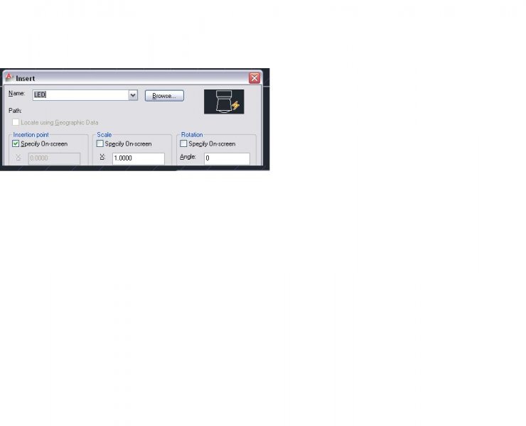

Hello guys, quick question, I have created a block and it has a little lightning logo next to it, I have never come a cross this, when I click on other blocks, the logo doesn't appear. Why is it there? Thanks :)
The lightning bolt means that the block is a dynamic block. However as you created it, it wouldn't be dynamic unless you made it so. Strange :?
What is the difference between normal and dynamic block? :) thank you for your reply

You should be able to double click on it, which will take you to the Block Editor, where you can delete the dynamic parameter, and save it again, which will make it a regular block.
