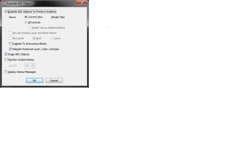

Also, the command AECOBJEXPLODE will do it without the need to create another file. I use these settings. You may need to select "All Layouts".
