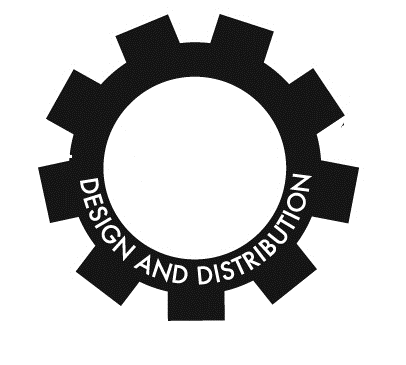

i did try to do it in illustrator but it did not come out right.i have a gear made in 3ds max i like the way it came out in there better because i can use the array tool and illustrator doesnot have one. what i was try do is get the type to bend inside the but can't figure it out in 3ds max i attach picture of what i want to do and my max file with the gear shape just trying to text on it .
