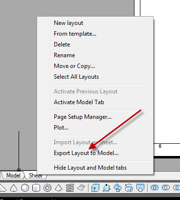

I want to open a DWG file in illustrator but only have the layout open, not the entire
drawing thats in model space.
Is this possible?
I believe 2009 had export to layout... if so export and save as .dxf (r12) then open in AI...
