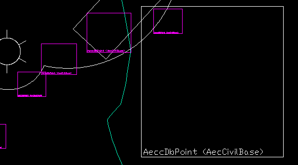

WindowsIHateYou Posted January 27, 2012 Posted January 27, 2012 Be gentle, n00b poster. Running ACAD 2008. Had to install Trueview 2012 to convert a file. Got tired of Trueview screwing my default open for dwg files, and uninstalled it. Went back into ACAD, and now my dwg files are filled with ye olde "AeccDbPoint (AecCivilBase)" boxes. I reinstalled Trueview, reopened my dwgs in ACAD, and I STILL have the "AeccDbPoint (AecCivilBase)" boxes. Help? Quote

WindowsIHateYou Posted January 27, 2012 Author Posted January 27, 2012 To Clarify: 1. The problem is not with how windows handles the files, or which program opens them. I was just commenting on why I had uninstalled Trueview, which may or may not have caused the current problem. 2. I actually DIDN'T convert/resave any files with Trueview in the end. 3. I am using _PLAIN_ ACAD 2008, the files correctly displayed earlier. After Trueview install/uninstall, the problem became apparent. 4. sample of error (see pic) Quote
