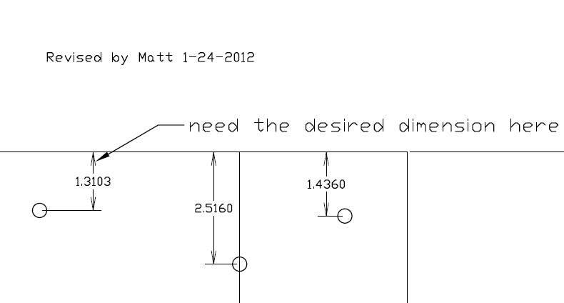

eldon Posted January 27, 2012 Posted January 27, 2012 I think that you are missing something. If you were to print out your drawing onto A4 paper, you would not expect to be able to read the text. However, if you were to print out your drawing onto an A0 sheet, you would be able to read your text. This is a screen shot of a PDF of your drawing, but using an A0 sheet. You can read the text very well. Quote
eldon Posted January 27, 2012 Posted January 27, 2012 I suppose that I ought to post the actual PDF file as well for you to see wine cellarA0.pdf Quote

Quik&Easy Posted January 27, 2012 Author Posted January 27, 2012 Eldon, that worked perfectly for me as well. I was saving it as you posted the actual file you created and Voila! I get all the detail I need for viewing and confirming stuff all in one file. In my version of AC, it was from the plot menu, paper size ISO A0 option; plot extents. I think we have a winner for the future here. ReMark, as I was typing, I heard from one of my clients; he had no trouble with the DWF; opened up fine in Photoshop and he loves it and hopes I can send stuff like that to him in the future. All in all, a very educational morning here in the pouring rain! Quote
