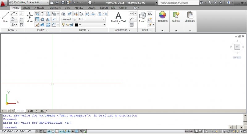

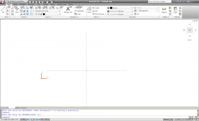

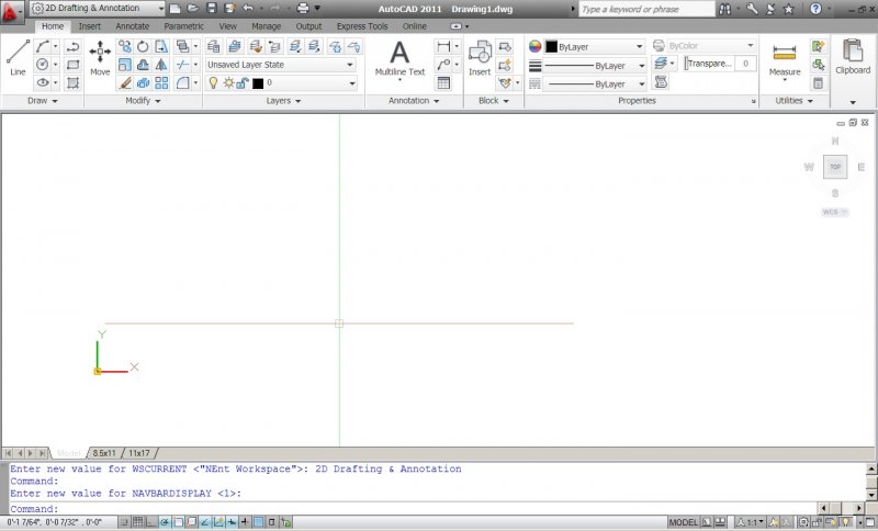

The higher the resolution, the more information you can see on the screen. Especially with the Ribbon, at 768, the drawing area will be very narrow vertically, roughly the same proportions as a cars rear view mirror.
Below are 3 screenshots of AutoCAD at 1366x768, 1440x900, and 1920x1200 on my 17 laptop. Notice how many more tools are visible as resolution increases.
Thanks nestly, that helps a lot.
