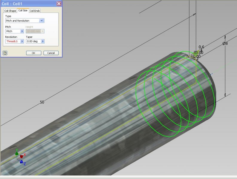

Good day to all. I Just want to ask something regarding Parameters. I was was trying to create a Thread of a customized Screw M8 and made some Parameter to be used for some functions.
Now, is the problem. When I input the parameters on the REVOLUTION fields of the COIL feature it does not accept the parameters value (ThreadLG=50).
Is it possible to input Parameters value or only plain numbers?
Thank you for any feedbacks. Appreciate it.

Is there a mismatch in units? For instance, is it expecting a unit of length, but ThreadLG is unitless?
Revolution is a unitless value.
I haven't checked but ThreadLG sounds like thread length, which of course is mm (or in) units.
Try dividing by 1mm to cancel units.
if ThreadLG=50 do you really want 50 threads or do you really want to set it to pitch and legth rather than pitch and revolutions?

@JD - The best would be pitch & length. But, for this instance I do wanted to make a full thread with the rod length is equal to 50mm.
- Sorry for not attaching the file automatically as it is not that complex to make the part. Its just a rod Dia. 8mm x 50mm LG.
Then why do you have it set to create 50 threads (Revolution)? Is your Pitch=1
Did you do the cancelation of the mm units for Revolution (a ul parameter)?

Anyway, I did followed what you guys have mentioned and it does accept the Parameters that I have created. ;) stupid of me :ouch:
