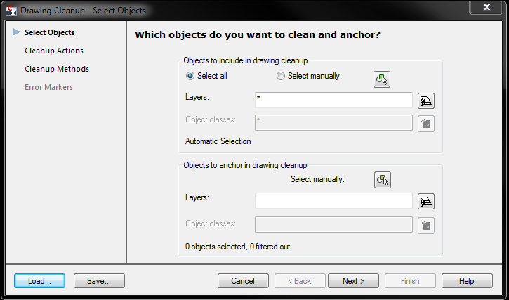

Since you have Map 3D you already have within your tools one that is very powerful and overlooked. Drawing Cleanup. It is a tool only found in Map 3D. The first part of the dialog lets you choose the entities you want to work on by several methods (i.e. layer, selection, etc.). See the images below.
