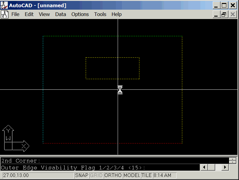

grdraw & grvecs in various releases
I wonder why this works in some releases and not others ( 2004 & up )

I just want to toggle the solid line vs dashed line using the lines color as the inputs
