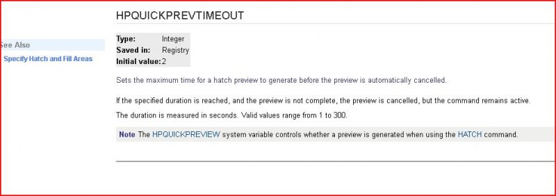

Dadgad Posted February 3, 2012 Posted February 3, 2012 Interesting, I never knew about this before. Seems you can make the preview time out, but continue the command, also. Quote
nestly Posted February 3, 2012 Posted February 3, 2012 Apparently HPQUICKPREVTIMEOUT was added to 2012 to address the problem HPQUICKPREVIEW causes, as that command does not exist in AutoCAD2011. Matt, is hatching slow all the time, or only when hatching complex regions or complex drawings? IE, if you start a new drawing and draw a circle, is hatching still slow? Quote
