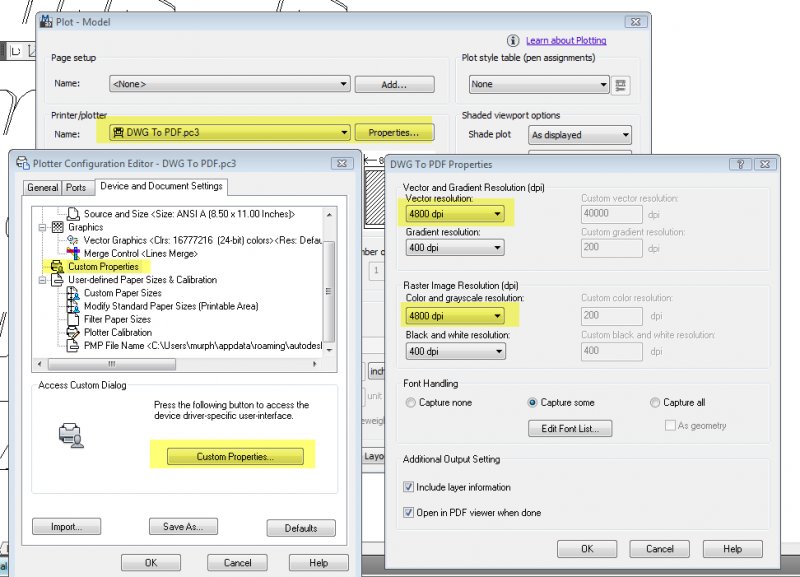

I'm using 2011. I made a pdf of an excel file, attached it to my drawing. Then I made a pdf of the drawing, and the pdf is coming out really poopy (numbers hard to read). Anyone know a fix?
Other than bring in the Excell file straight into CAD (OLE or ACAD Table) you may need to adjust the properties of your PDF plot settings.
Another way may be to copy-paste the excel table directly into CAD, instead of .pdf. You appear to be doing the equivalent of making a copy of a copy.
thanks everyone, I ended up dragging the excel file into the dwg rather than a pdf of the ecel file. And i got much better results =)
