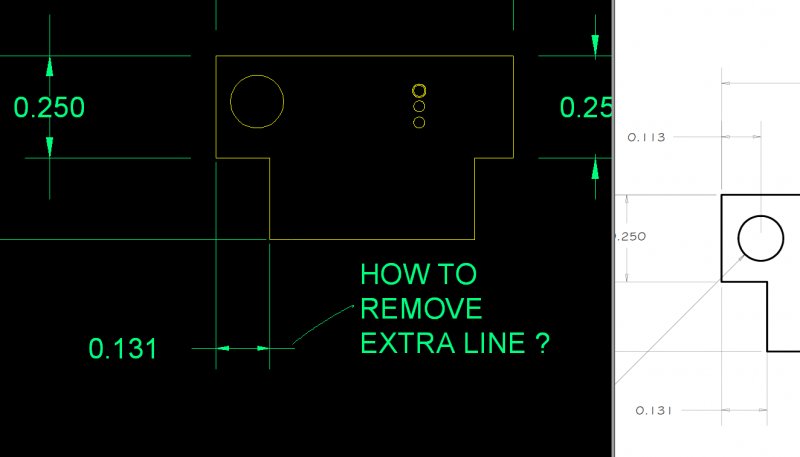

crosten2 Posted February 3, 2012 Posted February 3, 2012 Hi guys Can you guys help me on how I can adjust my dimension line to the drawing with the white background ? thank you Quote

crosten2 Posted February 4, 2012 Author Posted February 4, 2012 Hi guys How do i minipulate the dimension line in such a way that the picture with the black background looks like the one witht the white background ? I have spent a lot of time on variable to get rid of the middle line but cannot get it to look like the picture on the right. Thank you Quote

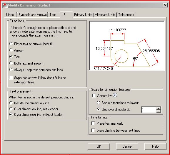

nestly Posted February 4, 2012 Posted February 4, 2012 Dimstyle > Modify > Fit tab Click the different "Fit Options" on the left, and watch the preview window on the right side. You'll figure out which one gives the results you prefer. Quote
nestly Posted February 4, 2012 Posted February 4, 2012 ... also make sure the "Draw dimension line between Extension lines" is unchecked at the bottom right under "Fine Tuning" Quote
Dadgad Posted February 4, 2012 Posted February 4, 2012 On the FIT tab > fine tuning uncheck "draw dimline between extension lines". Whoops, seems to be a bit of an echo in here. Yeah, what nestly said! Quote
