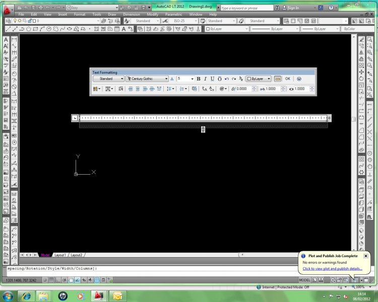

Elisabeth83 Posted February 8, 2012 Posted February 8, 2012 Hi We are working in Autocad lt 2012 and in one particular drawing we can't stop the slash (/) from turning into a fraction line . IE the date 08/02 becomes a fraction 8 over 2. Its very frustrating !!!!!!!!!! Help!!!!!! Quote

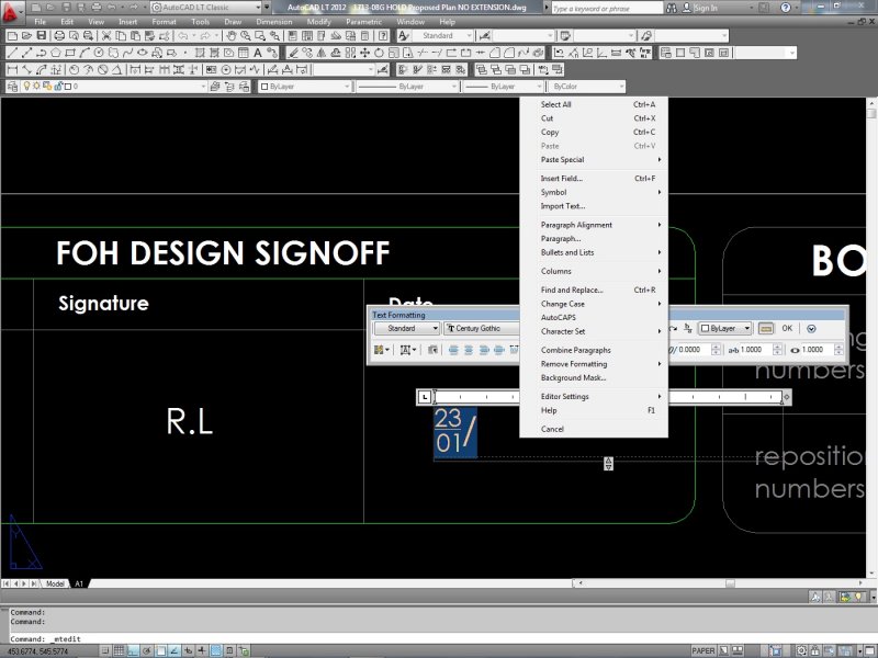

Elisabeth83 Posted February 8, 2012 Author Posted February 8, 2012 We have highlighted the text: But have no options relating to stack/autostack etc. Although it seems to be on one computor only. Others have the option to stack/unstack. The stack button in the text editing box also does not work ie is greyed out. Quote
ReMark Posted February 8, 2012 Posted February 8, 2012 Try highlighting the fraction and do not include the slash. Quote
Elisabeth83 Posted February 8, 2012 Author Posted February 8, 2012 Yeah!!! It works!! Thank you! Quote
ReMark Posted February 8, 2012 Posted February 8, 2012 Glad to hear it finally worked. I too had some problems with the feature (stack/unstack) after purposely duplicating your situation so it wasn't until I experimented that I discovered a way to fix it. You're entirely welcomed. Quote
