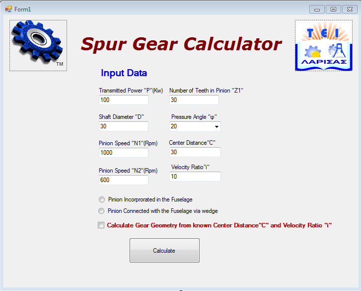

hello,i am new in programming and in my first successful attempt i developed a windows form based stand alone application in Vb.net 2010 that calculates all the geometry data needed for a Spur Gear ,my final goal is to send all Calculated data needed in Autocad 2012 and draw automatically the Spur Gear.
