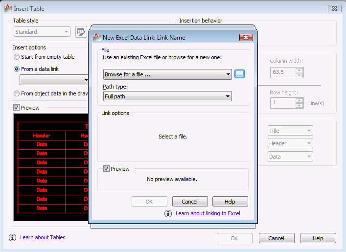

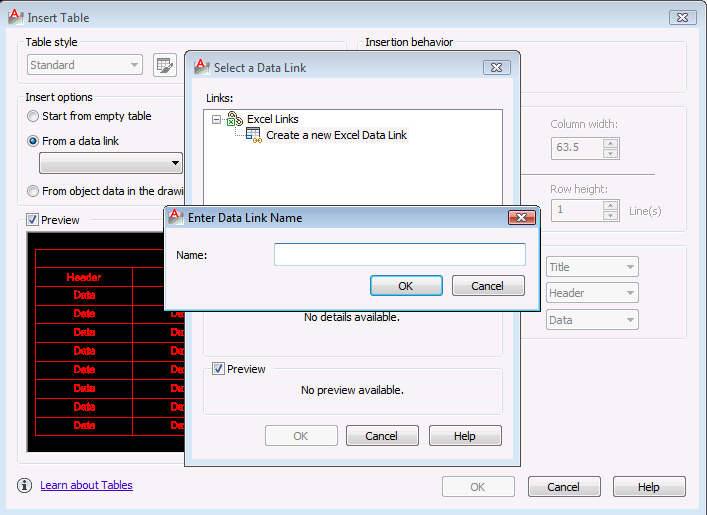

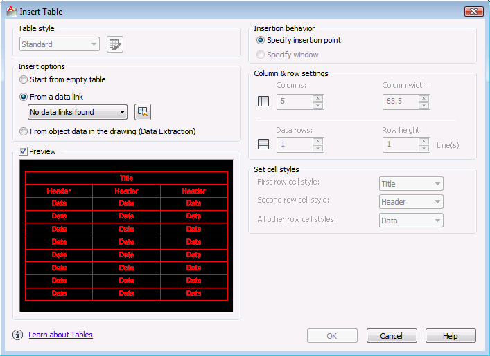

Here is how you do it:
First you excecute the command "Table"
Then you select "From a data link"
Then browse for a data link
Then create a new data link
Click "Browse for an file" and browse to the file you want to insert.
Press 3x OK and insert your table.
Now your table is the excel sheet.
When you changed it in Excel, you can type "DATALINKUPDATE" to update the file in AutoCAD.
