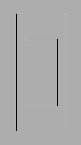

I created two randomly placed rectangles. How can I align the centerlines of the rectangles to be colinear, vertically or horizontally?
Thank you for the help
rectanglealignment.dwg
Circles are easy. With your properties box open select all of them and assign the appropriate X or Y coordinate.
I think the rectangles have to be done one at a time. Mr. Mather's method is the way I would do it.
Use the Mid between two points :D
Gives you this in one move
