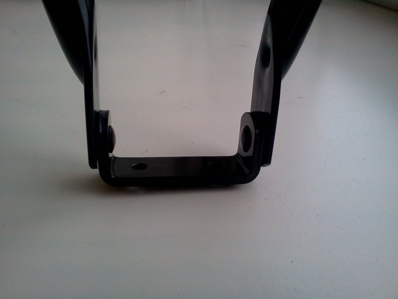

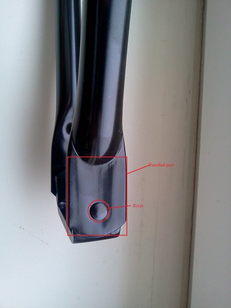

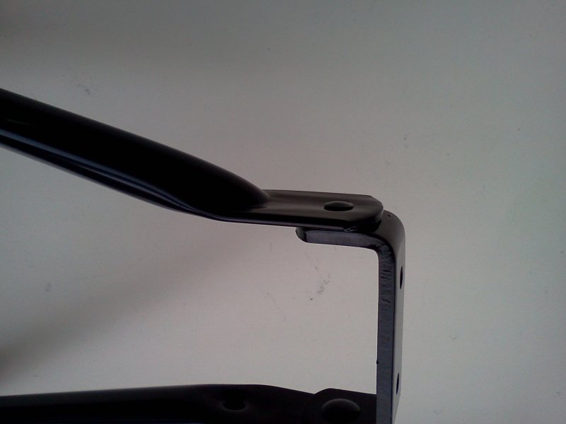

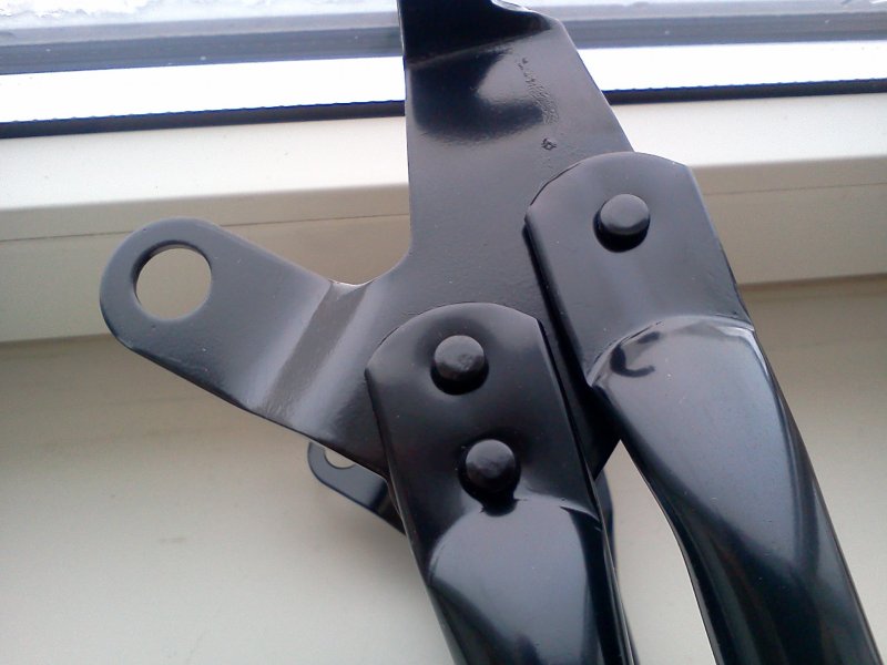

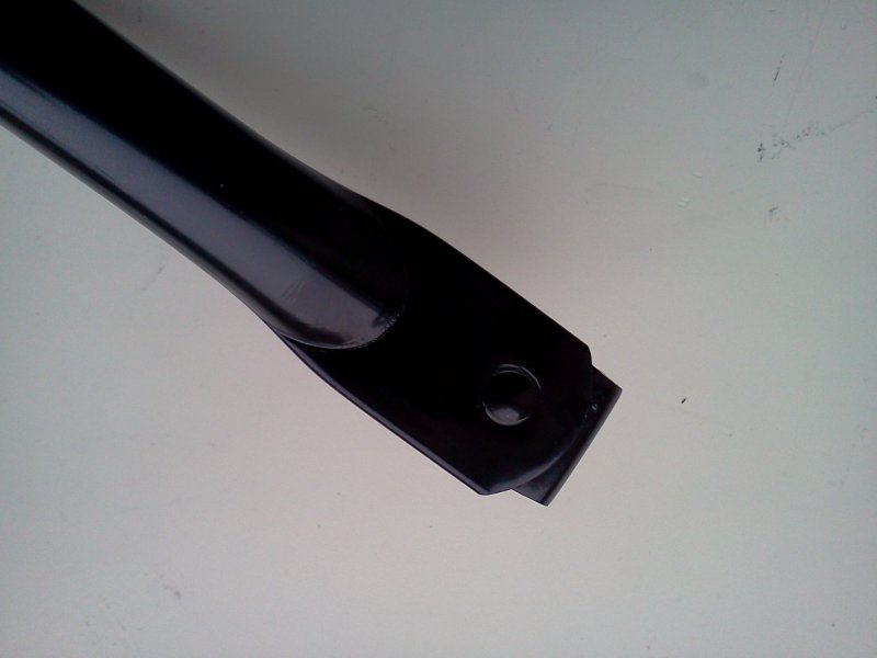

Hello, maybe anyone knows, how to make end of the pipe punched like in the picture? I thought about loft command, but I failed with it. So maybe Inventor has punch command? And other question, about rivet, I can't find it in the library, is my library not full, or Inventor doesn't have such standard parts?
The feature will be made with Loft (attach your attempt here).

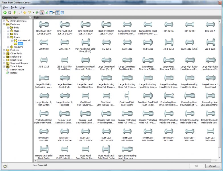

Attach screen capture of what you see in your Rivets library.
In any case, it should take less than 5 minutes to create a Rivet.
What's about rivet, so now everything is ok, I found it, thanks.
And now punching, I tryed, make punched from both side (Ramstis1), that flat part would be in the center of the pipe, and I think, I made it quite well, but please comment, maybe it is the easier way. But how to make punch for top frame I still do not know, so please help. Punch should be like in the CAD drawing.
